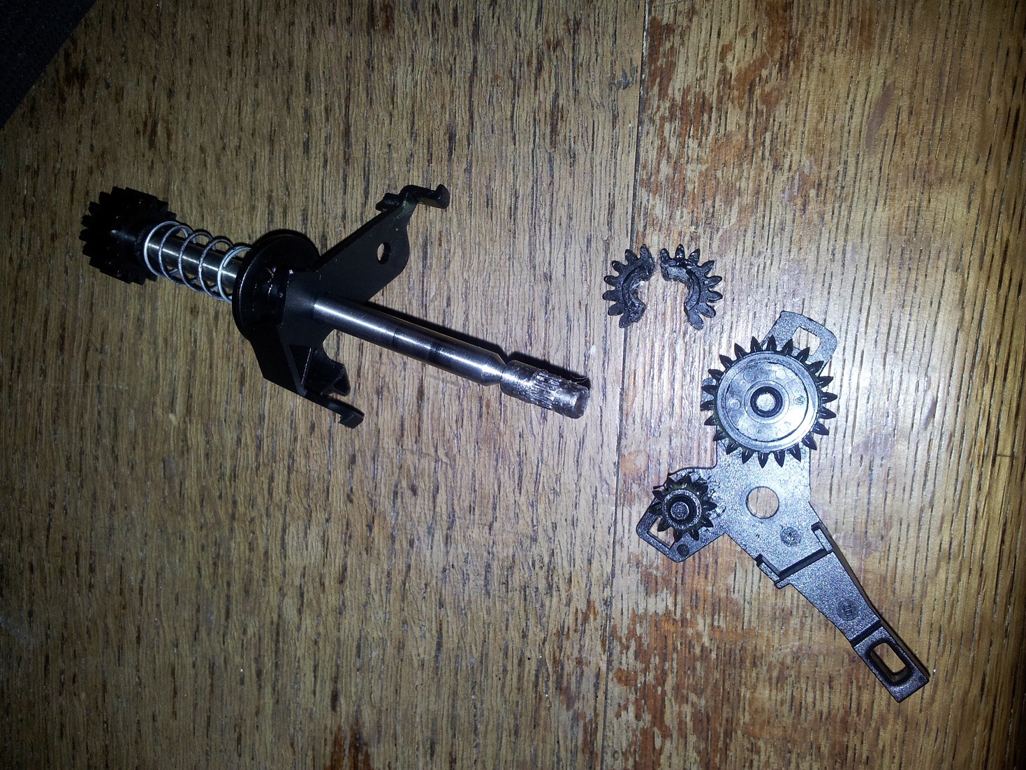

I have a problem with my beloved printer) HP Photosmart C5280 broken piece (PC +10 GF) and specifically small plastic gear.
In this part got 3 gear , so that broke which is in the middle and attached to a metal shaft.
Where can I find these parts, or you can send me the item by mail?
I do not want to throw away the printer because of this very little damage.

I have the exact same gear broken on my printer (but it is 5580) My gear was stripped out in the center and then a tooth broke off...it is the same black platic center gear...I even tried to epoxy it together but it did not hold...have you found a solution yet?...

Your broken gear comes from the left side of the printer (your right facing the front).  That gear can be replaced if you are handy with model making.   I may have a gear blank that can be machined to fit that transfer gear set if you can supply me the dimensions of the gear.  I do not know if your gear is the same as the ones on the aio 6500a plus, 710n.
Dimensions needed to see if I can supply gear are:
  1. Measurement in inches of the outside diameter of the teeth AND number of teeth.
  2. Inside diameter of the teeth root ( items 1, 2, will help determine the pitch diameter)
  3. The shaft diameter hole (should be 0.1875 inches). The gear press fits on the metal splined shaft.
  4. Measured distance between the shaft gear and the driven gear center (the one that turns the white gear) that moves the parking/ink catch tray.
  5. Thickness of the gear at the teeth and hub (if any)
My concerns:
You show the drive shaft completely taken out of the printer- how was that done?  You may have destroyed something else taking that out so replacing the gear may not solve the issue.
Cost of replacement may be more than you willing to invest in repairing that printer.
Comments:
I cleaned out all the goo from partially dried ink from the ink catch tray, fixed my transfer gear drive and the printer worked fine for about 50 sheets. ( It takes quite a number of prints to get the ink flow properly after cleaning the print head)  Put it back into service and the paper pic (bulk paper feeder) started to randomly then totally fail to feed.  That paper pic-part is being investigated now.  Total life time printed pages about 5600
