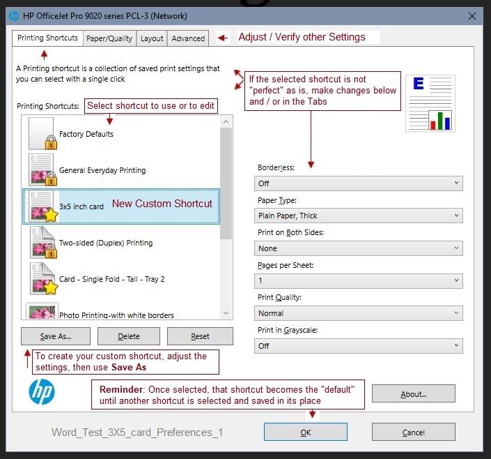

Set the Preferences - Windows
  1. The following assumes the Full Feature Software has been installed.
  2. Check / enable the printer as the “Default Printer”
  3. Select and adjust settings in each category for the Media (kind of paper), source (tray), and paper size.
Control Panel > icon view > Devices and Printers > Right-Click on your printer > Set as Default
Control Panel > icon view > Devices and Printers > Right-Click on your printer > Printing Preferences >
Tab Printing Shortcuts > Click / Highlight preferred shortcut > Click Apply > Click OK to exit
If the printer software supports the feature, change the settings as desired, then use “Save as” to create a Custom Shortcut.
OR
Windows key + S (search for) Printers and Scanners
Left-Click on (your) Printer > Manage >
Select a shortcut and / or set “preferred settings” for paper, source (tray), other settings
Optional (if / as available): Save As > enter a name for your custom shortcut
Click OK to save the preferences

Assuming the ability to print A4 borderless is there, I would guess that the issue might be one of the printer software not reading the settings correctly, the settings not being configured completely, or the installation of the software needs to be removed and reloaded.
If you did indeed completely remove all the printer software, including any leftover bits in Devices and Printers and the software that hides in the user account, then reinstalling again will not likely fix the problem.
That leaves that the configuration may not be set - since the A4 is not listed in the Specifications as supporting borderless, perhaps you had a custom shortcut created for this setting that included the A4 as a custom paper size for borderless printing.  Ordinarily, custom shortcuts might survive reloading the software - not always and not when all traces of the previous installation of that software were removed prior to reinstalling the printer software.
If you have not done so, consider trying the HP Smart for Windows software.
