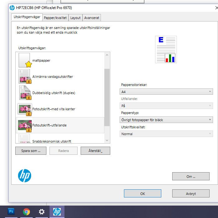

Hello i have this printer HP OfficeJet Pro 6970 All-In-One Printer.
When i try to change printer settings to borderless i get an error saying choices conflict.
Also all the different settings you can choose from has little locks on them.
And does anyone know what settings to choose to get best quality when printing out posters on thicker matte paper?
Should max dpi be on or off? Should HP Real Life Technologies be on or off?

Borderless Printing: Select this feature to print photos without border. Not all paper types support this feature.
You will see an alert icon beside the option if the selected paper type in the Media drop-down list does not support it.
The locks are the default printer shortcuts, you can make changes & then save a new shortcut under you own name ie. A4draft
Use the Best setting for posters and matte paper.
Leave HP RLT setting on.
