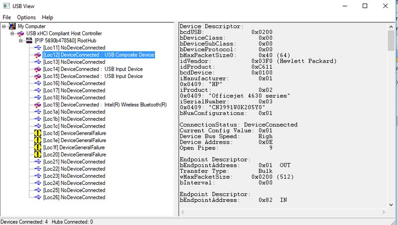

I downloaded a fresh copy of the driver (OJ4630_198.exe), ran it, and got to the Connections Options window (2nd screenshot below), selected USB, clicked Next, and got the Connect the USB Cable window. At this point I connected the USB cable but nothing changed; I only had the Back button and a grayed-out Skip button (1st screenshot below). To ascertain that the printer was visible to the PC on a USB port, I ran USBview (see 3rd sreen shot below). Any further suggestion?

Greetings @LeonKho, I am the @Chimney_83. It looks like you were interacting with @DavidSMP, but he is out of the office today so I'll take over from here.
Thanks for the reply and trying the suggested steps.
Request you follow the procedure mentioned below to uninstall the printer software and setting completely and install it back.
Set it up using USB connection and then convert it to wireless.
  • Uninstall the printer from "programs and features" which can be accessed by doing a right-click on the Windows button (Please have the printer Off and disconnected during uninstallation.)
  • Check in device manager, if the printer is listed there, please delete it. (Right-click on the Windows button to access device manager)
  • Go to devices and printers, select any printer listed there and you will get some options on the top.
  • Click on print server properties.
  • You will get a popup, click on the drivers tab and delete all the HP printer drivers listed there, if any.
  • Delete all the instances of your printer listed in devices and printers.
  • Restart the PC.
  • Once the PC is on the desktop, press Win + R, it would bring a Run dialog box,
  • Type %temp% in the run box and click Ok or hit the Enter button.
  • It would bring up the temporary files folder. Delete the files in the folder (You might not be able to delete all the files, ignore them).
  • If possible, delete the printer from the registries using Regedit or using any other 3rd party application.
  • Restart the PC again.
  • Download the latest full feature driver from www.hp.com/drivers and install it on the computer.
  • Power On/Connect the printer to your computer only when the setup prompts for the printer.
Let me know if this helped.
Chimney_83
I am an HP Employee
That worked!!! I guess the conclusion is that there was some corruption of files on the PC?
