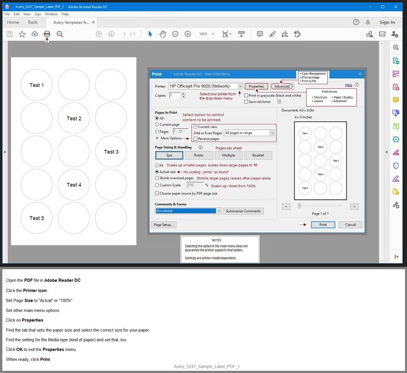

Open the PDF file in Adobe Reader DC
Click the Printer icon
Set Page Size to "Actual" or "100%"
Set other main menu options
Click on Properties
Find the tab that sets the paper size and select the correct size for your paper
Find the setting for the Media type (kind of paper) and set that, too.
Click OK to exit the Properties menu
When ready, click Print
What else?
Print the PDF file as an image onto your paper...
Example
The example is the plate from the Avery 5247 template - essentially the same label set.
Avery_5247_Sample_Label_PDF_1Avery_5247_Sample_Label_PDF_1
