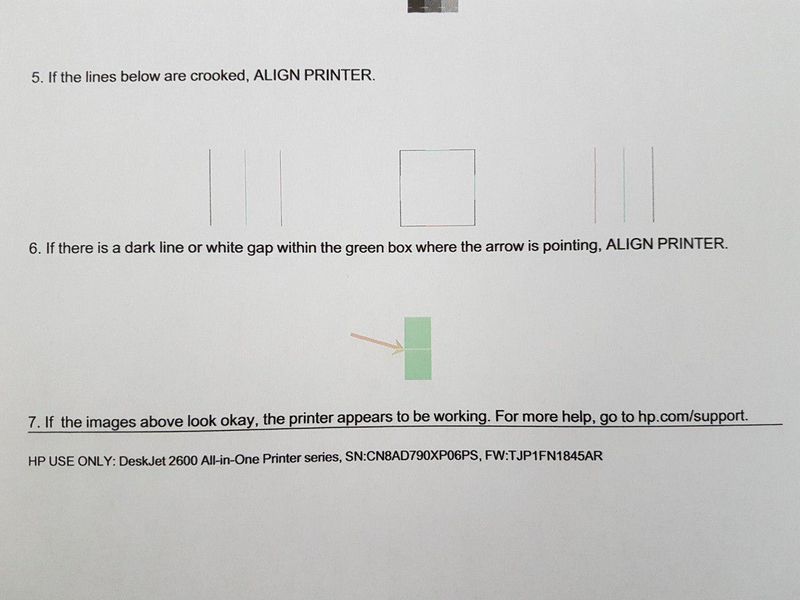

I've recently bought the HP DeskJet 2630 and when I'm printing the colors aren't correct.
I've tried alignment, cleaning the cartridges, more alignment and more cleaning... Nothing.
Clearly the CMY colors are wrong.
All of them are darker than they should be. Yellow is looking green.
Here are some pictures.
What the printer prints...What the printer prints...How it should beHow it should be
Thanks for all the help, @Jeet_singh
The problem in fact was the color cartridge. I've received a new one today and the problem is gone.
Thank you again!

Now answering your questions:
Have you recently made any changes before the issue started?
No. And the problem occurs printing from Android Smartphone too.
Are you using genuine HP Ink cartridges or refilled ink cartridges?
Genuine HP Ink cartridges. They came with the printer.
Have you tried to update the printer firmware?
Yes. It is up to date.
What happens when you try to print the print quality diagnostic report from the printer?
Prints normally, but the collors are also incorrect. The allignment doesn't look good either.
I've done the hard reset and the results were pretty much the same.
Here are the pictures for the printings before and after the reset.
All the colors look darker than they should be.
EXAMPLES:
Print Diagnostic BEFORE Hard ResetPrint Diagnostic BEFORE Hard ResetPrint Diagnostic BEFORE Hard ResetPrint Diagnostic BEFORE Hard ResetPrint Diagnostic AFTER Hard ResetPrint Diagnostic AFTER Hard ResetPrint Diagnostic AFTER Hard ResetPrint Diagnostic AFTER Hard ResetColor TestColor TestHow the colors should beHow the colors should be
How the colors were  printedHow the colors were printedHow the colors should beHow the colors should be
@ERNunes,
It's great to have you back and your patience is greatly appreciated.
After reviewing the post thoroughly, I suspect this to be a possible hardware failure. I will share you few details through a private message about the service options dedicated to your product, please watch your inbox for more information.
Thank you again!
