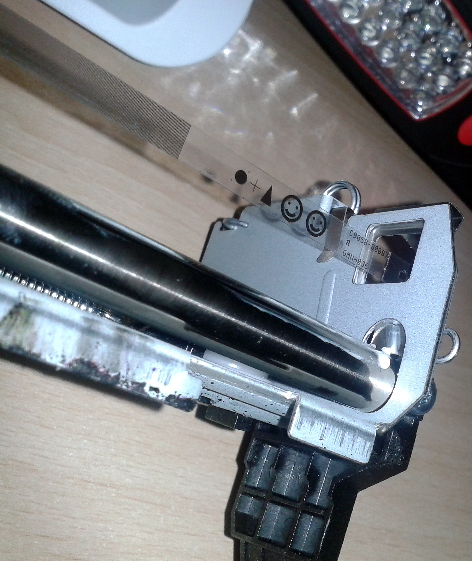

Hi There !!
Same problem here.
encoderstrip away.
http://h30492.www3.hp.com/t5/Drucker-und-All-in-One-Ger%C3%A4te-Nutzung/HP-Officejet-6000-E609a-Foli...
After replacing encoderstrip the carrieage hits hard from side to side.
think i missed the sensor in carrieage !?
how can i see if im in sensor or not !?
 Any solution !?
Matthias
Pictures from post above !!
cant edit post !?
encodergeklebt.jpgencoderstreifen_druckkopf.jpgencoderstreifen_links.jpgencoderstreifen_rechts.jpg
Ok, problem was -> i missed the sensor in carriage !!
Now works !!
Thx for help.
Thx to Bob_Headrick who post the photos to solve encoder strip problem.
