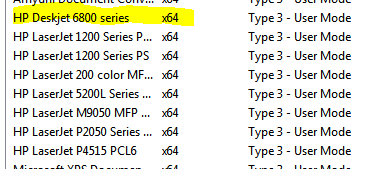

An update .. and a request for advice to proceed.  Note that we have a total of three HP printers on our network. A very old HPLaserJet 1200, an HP LaserJet 200 colorMFP, and my HP OfficeJet Pro 6230.  As you can see below, the drivers for those printers are shown.  I would very much prefer NOT to delete them just to fix the prob with my 6230.  The HP DeskJet 6800 was the HP 6230's predecessor. It served well and true for nearly 10 yrs until it jammed itself beyond repair (leading to the purchase of the 6230).  When I tried to delete the 6800 driver completely (driver & package) I couldn't; apparently something is shared with the 1200.  I was able to delete just the driver, which I've done.
Have no idea what the other HP drivers refer to; suspect they have something to do with the MultiFunction aspect of the HP LaserJet 200 MFP.
Bottom line.. how should I proceed?  Please don't tell me that to fix the driver for my 6230, I need to uninstall (and reinstall) the drivers for our other HP Printers too.
Thanks!
