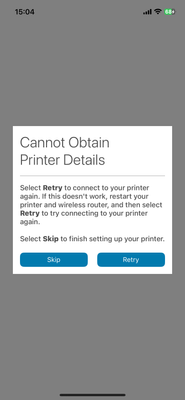

Hi i have pinter HP desk.Jet 2700
but before was working normally and the start showing error 0E and in saying and in the HP smart is saying conect to HP ink but when i try to connect start shoing error EE
and lights are flashing.

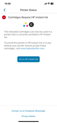

Hi @NANS099,
I'd be happy to help you!
An E0 error indicates an unusable cartridge. This condition occurs when at least one ink cartridge needs attention, is faulty, incorrect, missing, damaged, or incompatible.
Are you enrolled in the instant ink program?
Meanwhile, try the below suggestions -
