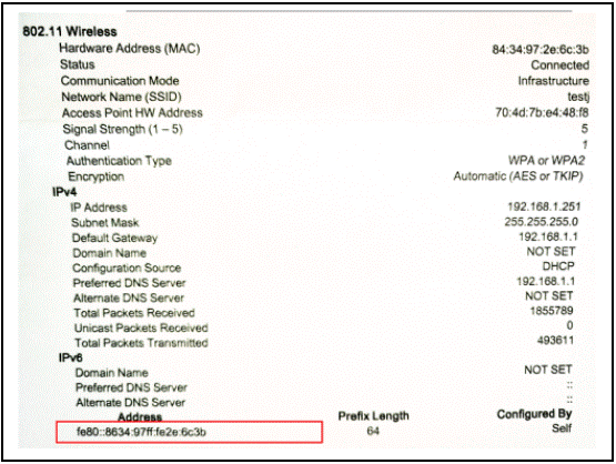

Find the printer IPv6 address in the 802.11 Wireless section of the report. The address starts with fe80.
Example of an IPV6 address on a Network Configuration Report

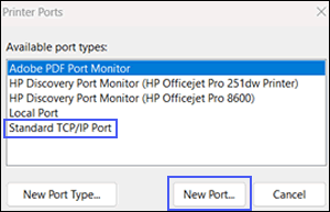

On the Ports tab, click Add Port.
From the list of available port types, select Standard TCP/IP Port, and then click New Port.
Creating a new Standard TCP/IP Port

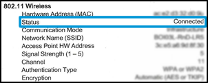

Wireless status: Under 802.11 Wireless, the Status should be Connected. If it is not, your printer is not connected to the wireless network. Connect your printer to the network. For more information, go to Connect to a wireless HP printer.
A Wireless Status of Connected on the Network Configuration Page

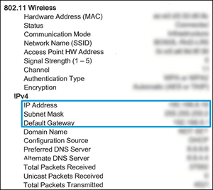

IP Address, Subnet Mask, Default Gateway: Under 802.11 Wireless, find the printer's IP Address, Subnet Mask, and Default Gateway numbers. If you see different numbers for IPv4 and IPv6, you only need the IPv4 numbers.
Identifying the IP Address, Subnet Mask, and Default Gateway on the Network Configuration Report

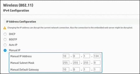

In the EWS, click the Network or Networking tab, open the Wireless menu option, and then click IPv4 Configuration.
Select Manual IP, and then provide your printer information.
Manually setting a printer IP address in the EWS
To auto-fill all fields, click Suggest a Manual IP Address, and then make sure the fields for Manual IP Address, Manual Subnet Mask, and Manual Default Gateway match your printer's information on the Network Configuration Page.
If Suggest a Manual IP Address is not available, type the information from the Network Configuration Page into the IP Address, Subnet Mask, and Default Gateway fields.
Click Apply, and then wait until the changes are confirmed.
