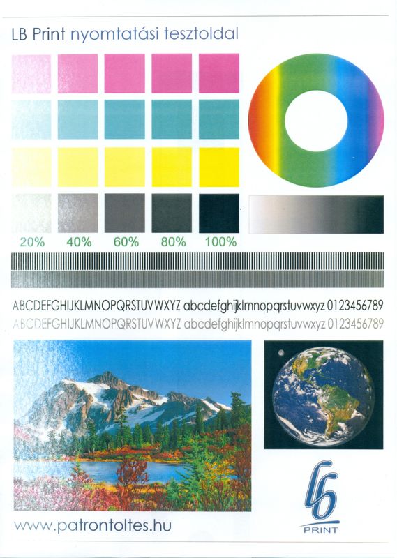

HP COLOR LASER 150NW print is fading on the left side of the paper around 5 cm-s wide along the entire paper length. All colours are affected. (It should not be a specific toner issue.) There are no spots on the fading. It fades evenly along the whole paper but only the left 5 cm wide band. The remaining part of the paper (right 15 cm band) looks good. I attach a test page below. I tried to remove the toners and the drum. I could not see any dust or damage on them. Does anyone have an idea what the problem could be?

10-24-2024 05:28 AM
Hi Alden4,
Thank you for your answer. Numerous disassembly, parts cleaning and reassembly finally helped. Maybe the toner collection unit was the one that I emptied and cleaned and after that the print quality became much better. Now only a small area on the bottom left side has some fading. The printer is just over a year old and has barely been used so far. (Even the factory ink was not completely used up.) I didn't want to immediately start replacing a part worth half the price of the printer.
