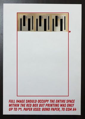

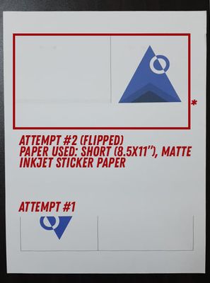

I am currently having a printing problem with my printer, an HP DeskJet GT 5820, which I haven't encountered before. It seems that I am unable to print complete pictures. That is, the printer cuts off the image (i.e. stops printing) at a certain point and then ejects the entire sheet, without an error message or pop-up showing on my screen. I am not sure whether it is the document format or the type of paper that has gone wrong, but this printing error does not happen when I print a text-only document.
I am attaching a couple of photos for reference:HP - Error 2.jpg
