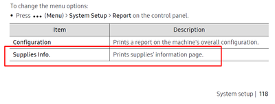

I cannot find "Menu" -> "System Settings" -> ...
There I could go only to "Printer Settings". And after going there -> I can go to the "Advanced Settings" which loads the page from the embedded printer web-application (I sent a screenshot from there at the beginning). Other menu items say nothing informative. (Win11).
There is also "Printer Reports" menu item, but on clicking on it shows the message like "please go to Advanced Settings, bla-bla-bla"
Could you please elaborate where the "System Setup" could be found?
read Control panel overview
I'm not an employee of HP, I'm as volunteer here.
I would be faster if you said that "Menu" is on the printer display.

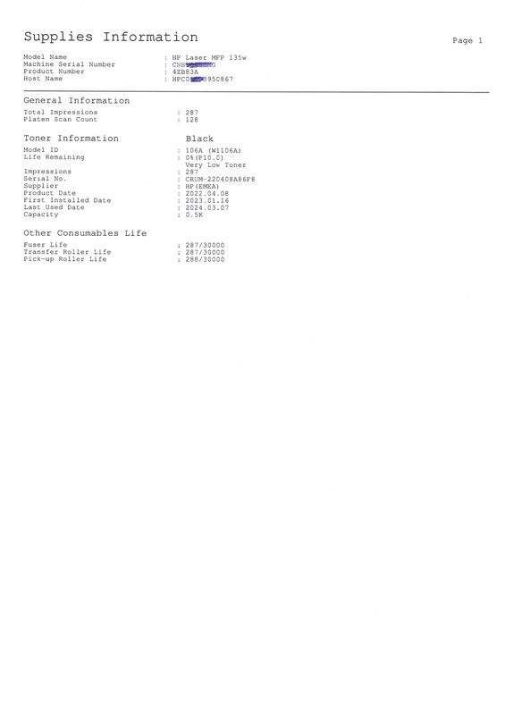

Alright, here we go. information inside matches to data in HP Smart application
Check the firmware version. The last firmware update was on January 25, 2023.
You purchased the printer before January 16, 2023.
The printer still has the setup cartridges, print capacity < 500 pages.
Keyword "redistribute toner" see manual
The cartridges were produced on 8.4.2022.
Therefore, remove the cartridge once, shake it vigorously back and forth and reinsert it.
From my point of view, everything is OK.
But you will soon need a new cartridge.
