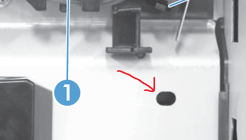

We removed the back cover and the voltage supply like the post above said. We checked the lever motion and found it sat a little low. The spring worked and everything looked to be intact, but it still wasn't engaging the sensor. We saw a hole that was barely visible on the other side of the lever (picture below of hole after lever removed ) and thought maybe there was a peg or something that was supposed to be there to ensure the lever sat up enough to engage the sensor. So we "MacGyvered" the printer, by cutting sticky computer feet tabs and placing one in the hole and then on both sides right below to hold it in place (picture below after lever was put back on with tabs). We re-inserted the left door and ensured the sensor was engaged.  Put everything back together and the "close left door" error did not appear.
Obviously, this isn't the most technical solution; however, when a printer is out of warranty and people need to print, this was our best solution and it worked. Our next option was to just remove the sensor, but we weren't exactly sure if the printer would initialize.
