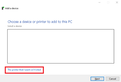

2) Go to Control Panel, open Device and Printers, click on "Add a Printer"
3) Click "The Printer that I want isn't listed":
4) Select "Add a local printer or network printer with manual settings"
5) Select your USB port that your printer is using:
6) Install it as Generic /Text Only
7) Download older Firmware update (find in google HP_LaserJet_Pro_M28_M31_Firmware_Update_20210121.exe
8 Install it for Generic /Text Only, restart your PC and install HP drivers as usual.

1) Turn On the printer
