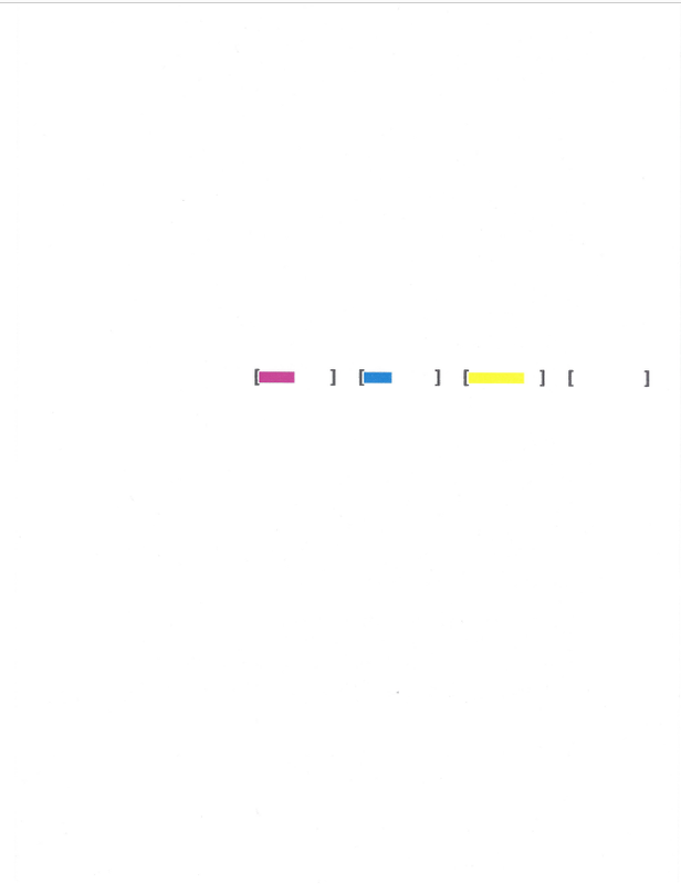

My HP OfficeJet Pro 6970 isn't printing Black in particular.
This is the troubleshooting I went with:
  • All colors working, other than Black.
  • All 4 cartridges are genuine HP.
  • Cartridge levels are more than half-full.
  • Attempted to hard reset - no luck.
  • Attempted to upgrade firmware - up to date.
  • Attached are alignment pages and test print pages (black totally missing).
  • Attempted to softly clean print head for Black cartridge - still no luck.
  • Cleaned print head (level 1, 2 and 3) & aligned via HP software - still no luck.
  • Tried to print from document and graphic - with no luck.
  • Below are attached scans.

@StefM91, Welcome to the HP Support Community!
Thank you for the detailed information. I appreciate your efforts in trying to resolve this issue by performing the necessary troubleshooting steps.
I'm afraid this is a hardware issue either with the black ink cartridge or the printhead. If you have already used a new black ink cartridge, then we can conclude it as a bad printhead.
Please reach out to the HP Support in your region regarding the service options for your printer.

Thank you for the information.
I've just called the service and mentioned everything I've done, they mentioned they do the same troubleshooting and it will cost me more to pay for the repair, then to pay for a new 6970 printer.
Also just checked and there is no longer warranty on my device. I've only ever used genuine HP cartridges and would like more information as to why after 2 years, I'm unable to use my device at all?

@StefM91
I understand your concern. The printhead has gone bad and i is not replaceable. As the printer is out of warranty, I suggest you upgrade the printer. You may visit Hp Store to check the available printers.
