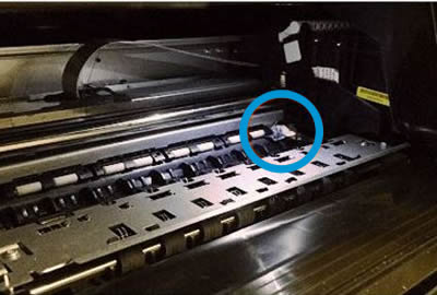

  • Look in the carriage path for debris such as crumpled paper or dislodged labels, and then remove any that you find.
Obstruction inside the printer

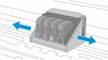

  • Use your hand to move the carriage to each side, making sure it moves freely. If the carriage is stalled or docked to one side of the printer and you cannot move it, continue with these steps.
Moving the carriage from side to side
