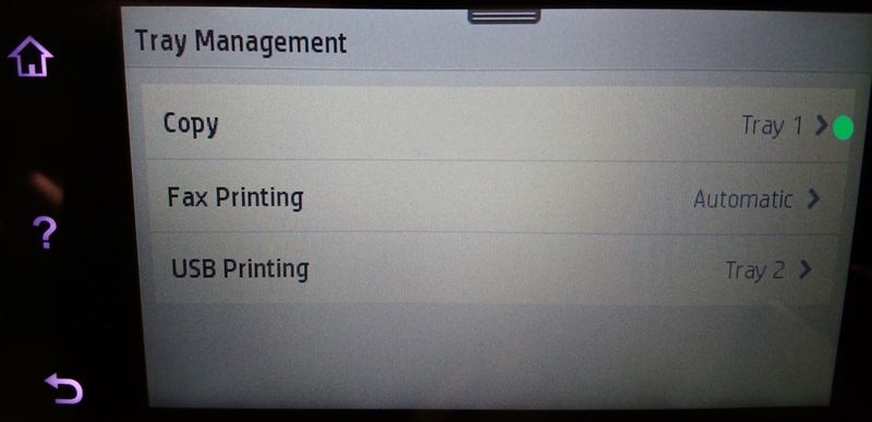

First I thought it worked, unfortunately it did not.
The copy document screen still shows tray 1 every time I open it.
Wolfram Schlich
In the Tray Management screen, Copy always switches back to Tray 1.
Wolfram Schlich

Hey, I did what you suggested but the Copy tray still switches back to Tray 1.
Wolfram Schlich
Hi @wschlich
Was Tray 2 "Locked"?
If it was locked, it will always go back to Tray 1.
Can you ensure that the "Tray Lock" settings is set to "None"
Let us know if that works!
