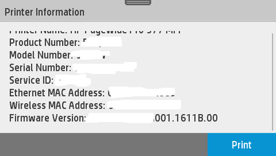

The date you have provided regarding the FW concerns me. As I have indicated I need to confirm the actual version you have loaded on the unit.
The FW location for 477 dw is here:
http://h20564.www2.hp.com/hpsc/swd/public/readIndex?sp4ts.oid=8808868&swLangOid=8&swEnvOid=4054
Could you please verify that the FW version is 1611B.
With the unit on, hit the question mark on the front panel when you are at the home screen, then go to the bottom of the menu to printer information. The FW version will be at the bottom.

Anyway, to make some more sense out of this conversation, I can confirm that I have a PageWide Pro MFP 477dw, that I have the newest firmware you mentioned (1611B), and that I have exactly the issue you mention here. I have to reboot the printer after it went to standby. Otherwise print jobs get stuck, and the PC generates an error.
