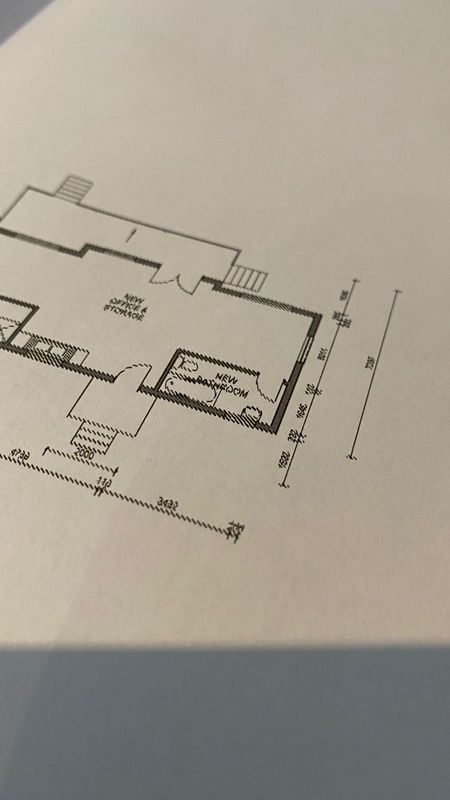

I've searched the net for anything remotely to what I've been battling with but came out empty handed, the issue is when ever I print a pdf document to A3 size on my Officejet Pro 7740 all the horizontal lines will print as a bunch of small backslashes. Vertical lines print normally. Seems to be isolated to A3 paper size making me think this might be a driver related issue?
Has anyone experienced anything like this before? Any help would be welcome!

Hi Gaya1239
Thanks so much for the suggestions, I managed to isolate the issue to Windows since A3 prints just fine from my phone.
Looks like the problem came in from the default drivers windows installed when I setup the computer in January. Installing the correct drivers from HP's website fixed the issue! Thanks again!
Backslashes for horizontal lines.Backslashes for horizontal lines.
After driver update.After driver update.
