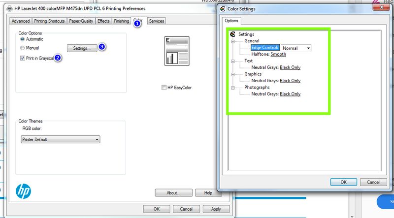

Ok, on the computer go to control panel>devices and printers and then right click on the icon for the printer and select printer properties from the dropdown menu.
Click on Preferences
click on color, change to grayscale and the click settings and change all options to black only
change to grayscale and then click settings and change all options to black only
Following this path will change the default settings for the currently logged in user. If you want to change all users click on Advanced and then printer defaults and make the same changes as above. This will apply to anyone using that computer.
