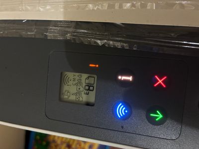

Please help to fix the attached photo issue

@Aalexis19, Welcome to the HP Support Community!
Thanks for reaching out about your query regarding E8 Error Code!
We're thrilled to have the opportunity to assist you and provide a solution.
This usually means a paper jam or carriage jam inside the printer. Let’s walk through a fix together:
Try This:
Power off the printer – Feel the soft click as you press the power button, then unplug it for safety.
Open the ink access door – Listen for any soft whirr or clicks from the ink carriage. It should move freely. If it's stuck, gently nudge it to the center.
Check for paper bits – Use a flashlight to peek inside. Clear out any jammed paper or foreign objects (even tiny torn corners).
Close everything up and plug the printer back in.
Power it on and wait for the sounds to settle.
Still flashing E8?
You might want to reset the printer:
Turn it off, unplug from power and wait for 60 seconds, then power it back up.
Let me know what you find — happy to stick with you until that printer hums happily again! 😊

Hi upon trying still E8 still flasing and already reset the printer. Any orher option to fix this issue
@Aalexis19, Thanks for reaching out! I suggest you reach out to the nearest HP Authorised service center for personalized assistance. They can provide one-on-one help to fix the problem.
Note: There might be a nominal charge for the service they provide.

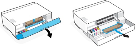

where is the access door?
@joy0722
Thanks for stopping by the HP community. A very good day to you.  I reviewed the post. I will be delighted to assist you here.
The access door of the HP Smart Tank 210 printer is located at the front of the printer. To reach the printhead and ink access area, follow these steps:
  1. Open the Front Door:
    • Ensure the printer is turned off.
    • Open the front door of the printer.
Opening the front door
  1. Wait for the Print Carriage:
    • Allow the print carriage to move to the center so you can access the printhead and ink cartridges safely.
  1. Printhead Access Area:
    • This will provide you access to the printhead cover where you can perform tasks like ink filling or replacing the printheads.
Printhead access area
Refer to the link below for more assistance.
HP Smart Tank 210 Printers - First time printer setup
If you're setting up the printer for the first time, be sure to remove any orange plastic or protective tape from the printhead area before proceeding.
