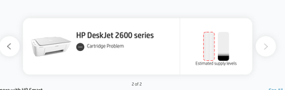

I bought a new ink cartridge tri color yesterday and installed it properly but my printer wont recognize it. Its able to detect the black cartridge but not the tricolor one. it says that it has cartridge problems and has no ink. The display panel also keeps blinking. It was detected yesterday for a short while, but when as i was starting to print something it was not detected again. I have followed all the suggested steps in all the forums here but could not get it to work.

Welcome to the HP support community.
I understand that you are getting a cartridge error, I am glad to assist you.
Reset the printer
Reset the printer to recover from printer errors or failures.
  • If your printer has a rechargeable battery, remove it.
  • With the printer turned on, disconnect the power cord from the printer.
  • Unplug the power cord from the power source.
  • Wait 60 seconds.
  • Reconnect the power cord to a wall outlet and to the printer.
  • NOTE: HP recommends plugging the printer directly into a wall outlet.
  • Turn on the printer to complete the reset.
Clean the ink cartridge and carriage electrical contacts
  • Remove any debris or buildup from the contacts on the cartridges and in the carriage.
  • Open the door or lid to the cartridge access area. Wait until the carriage stops moving before continuing.
  • Remove the cartridge indicated in the error message from the carriage.
  • Carriages with cartridge latches: Open the latch, and then pull the cartridge up and out of the slot.
  • Removing the ink cartridges with latches from the carriage
  • Carriages without cartridge latches: Gently press down on the cartridge to release it, and then pull it out of the slot.
  • Removing the ink cartridges from the carriage
  • Holding the cartridge by the sides, remove any protective tape that still might be on the contacts.
  • CAUTION: Do not touch the ink nozzles or the copper-colored electrical strip. Touching or trying to remove these parts can result in clogs, ink failure, and bad electrical connections.
  • Removing tape from the ink cartridge
  • Lightly dampen a lint-free cloth with distilled water, and then wipe the copper-colored contacts on the cartridge.
  • Cleaning the ink cartridge contacts
  • Lightly dampen a lint-free cloth or swab with distilled water, and then clean the electrical contacts in the carriage.
  • Cleaning the contacts in the carriage
  • Wait 10 minutes for the contacts to dry, and then reinsert the cartridge into its color-coded slot.
  • Repeat these steps for the other cartridge if it was indicated in the error message.
  • Close the door or lid to the cartridge access area.
Refer to this HP document for further assistance:- Click here
Keep me posted.
