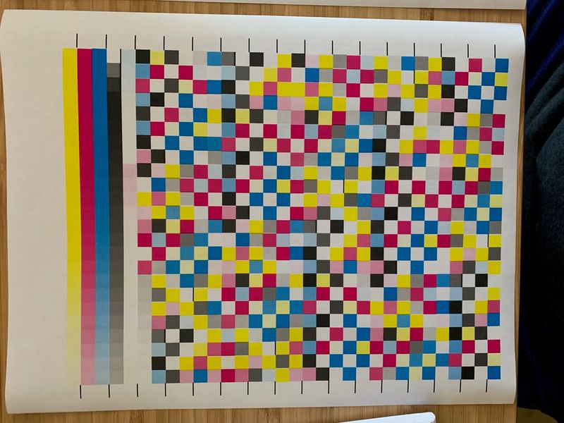

No matter what I do (with a new black toner) all my prints come out with missing lines/fonts/etc. See below. Image on the left is how it prints out vs what the PDF is on the right.  If I print the calibration sheet, ALL the pure black squares print grey with a single small line at the bottom. Image attached for this as well. Like I said new black toner. Any ideas?printer_issue.png

Hi. 100% with both cartridges. I have ruled out the toner unless I am that unlucky the new HP toner is doing it as well.
How do the print test quality pages look? Are you seeing similar problems with color. I would pull the transfer belt and look for streaks or marks on it.

Here they are. There are no streaks or anything like that. It just doesn't print the full black squares. Crazy.
