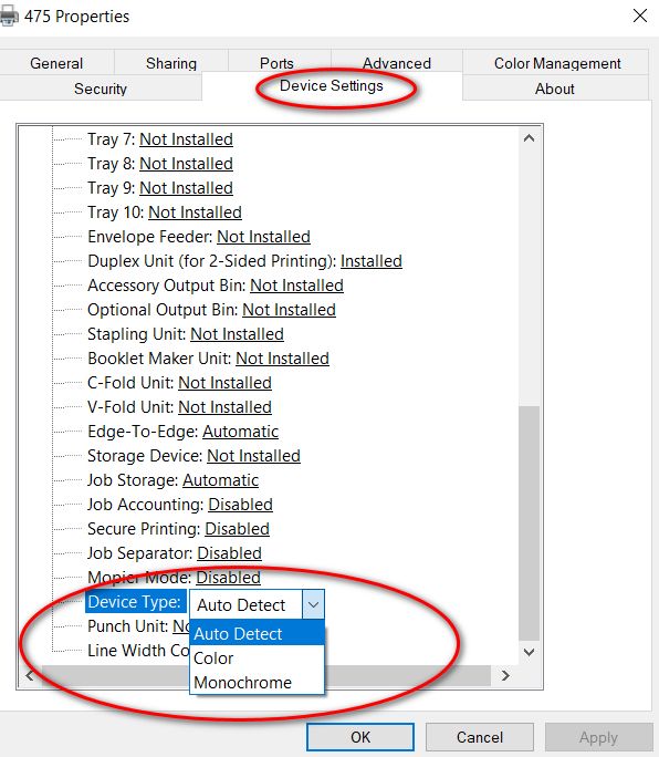

In terms of the color issue, can she copy in color? If yes then the driver is either wrong or the driver did not detect that the device was capable of printing in color. There is a setting in the driver for device type. On the PC, go to control panel>devices and printers and right click the icon for your printer and select "printer properties" from the drop down menu and then click on the device settings tab and scroll down the options till you find device type and change it to color.
