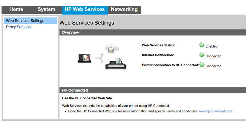

In my case I just connected to the printer by the http printer console and activated the web services tab.
My printer has ever been offline before, I used to print by the usb cable.
After it was connected to the wifi network and were activated the web services (it requires to log in as admin and use the serial number of the printer as password) it started to print again  Hp.PNG
This made the trick for me,
I hope it can be usefull for somebody else.
