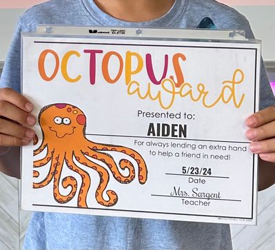

Each time I print the last inch of the image/text is not printing. I have tried changing setting and such, but have had no luck. Has anyone else had this issue? How do I fix it?
See attached image.
Thank you!
PRINTER: HP DeskJet 2700 series (669A85)

You might be running into the printer's margin limitation.
DeskJet printers typically require a larger margin along the bottom edge.
If you rotate the print, the larger margin moves to the side.
Borderless PrintingNo
Print Margin Bottom (A4)12.7 mm
Print Margin Left (A4)3 mm
Print Margin Right (A4)3 mm
Print Margin Top (A4)3 mm
There is no software, firmware, or alignment that changes the larger margin requirement.
The solution to "chopped off" is to keep all data inside of 1/2 inch / 12.7mm on the bottom edge.
This limitation includes all text, images, page numbers, footer information, cells, tables, lines, other notations, and all file types, too.

  • The shape of the original image does not exactly match the shape of the paper.
The image must be made to fit the paper by editing the original image or perhaps using Crop during job submission to fill / force the shape of the image to match the shape of the paper.
Use "Fit", "Shrink to Fit", or similar to force the PDF content inside of the allowed margins.
Centering the content depends on the app / software, the margins, and the shape of the photo as compared to the shape of the paper (Aspect Ratio).
