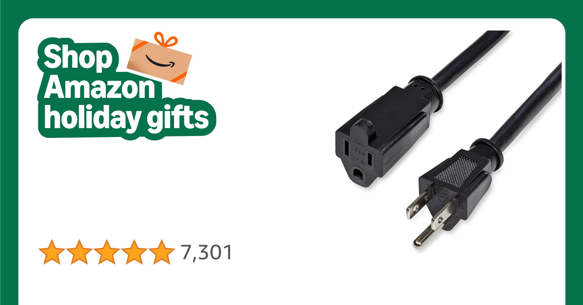

https://www.amazon.ca/StarTech-Power-Cord-Extension-Negro/dp/B002VY53QE
The above is equivalent to what shipped with the printer. Under normal circumstances there should be no issues with this cord. I am concerned that this worked for a year and suddenly you are having a problem. This suggests something has changed, either the printer has developed a short or something in your house wiring is suspect. You could have an overloaded circuit. This type of problem is a fire and safety hazard and you need to find the cause of the problem. If you recently connected new devices to the same circuit such as an air conditioner the circuit is likely overloaded and you need to move things around onto another circuit.
