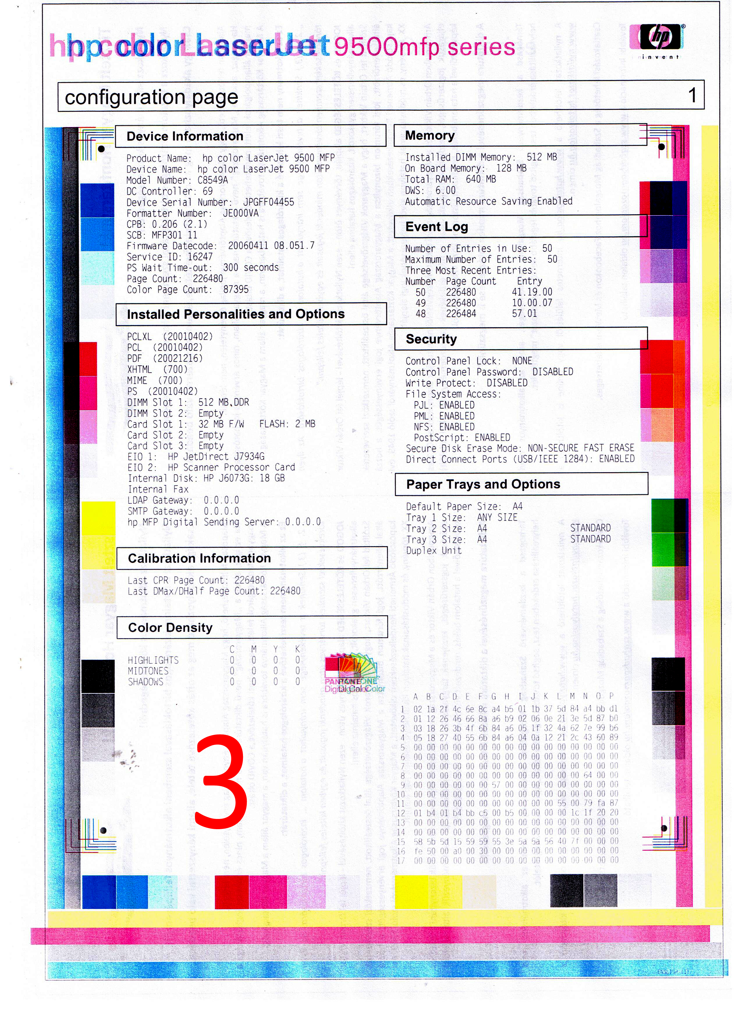

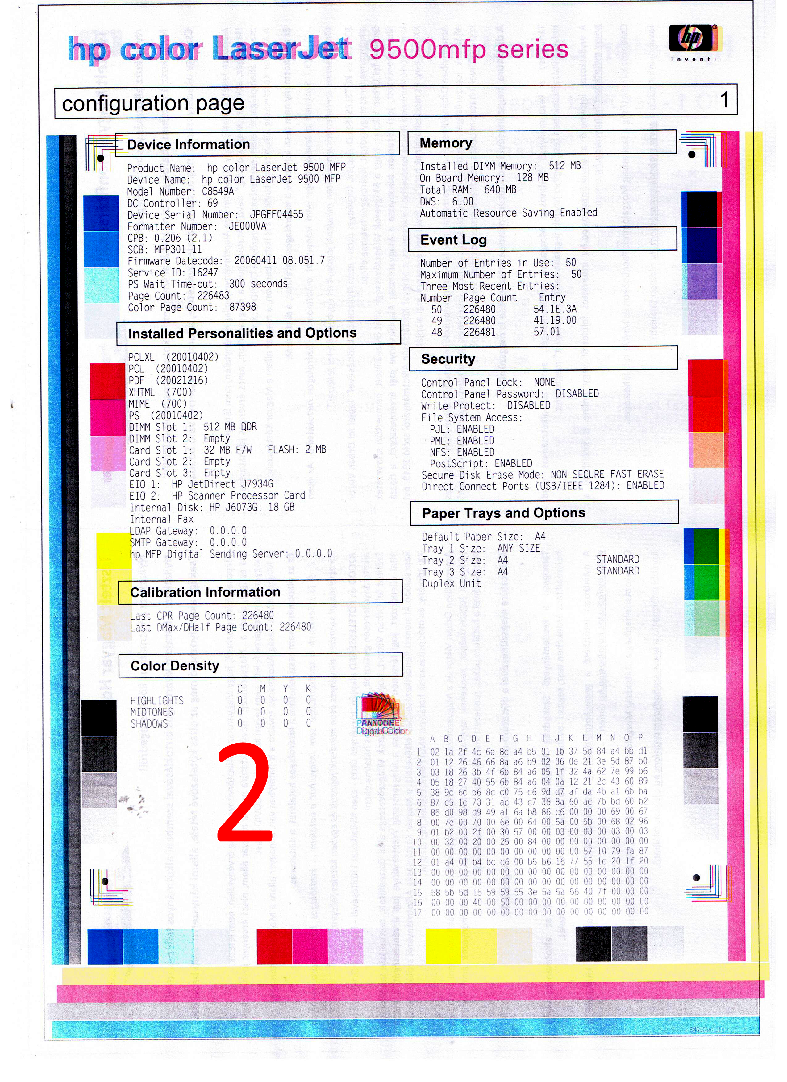

I have a "dancing" or "jogging" color planes which moves 1-5mm left or right randomly on every page.
It is not a reigstration-related problem, because every printed page have different positions, sometimes even matches the good position as well.
I have cleaned all of the sensors what i can, including the 4 encoder plates and IR-gate-pairs on the developer motors, and the density sensor as well.
Can somebody tell me what to try, where to start?
Pictures:
02:
http://lefel.1-click.hu/clj9500/02.png
03:
http://lefel.1-click.hu/clj9500/03.png

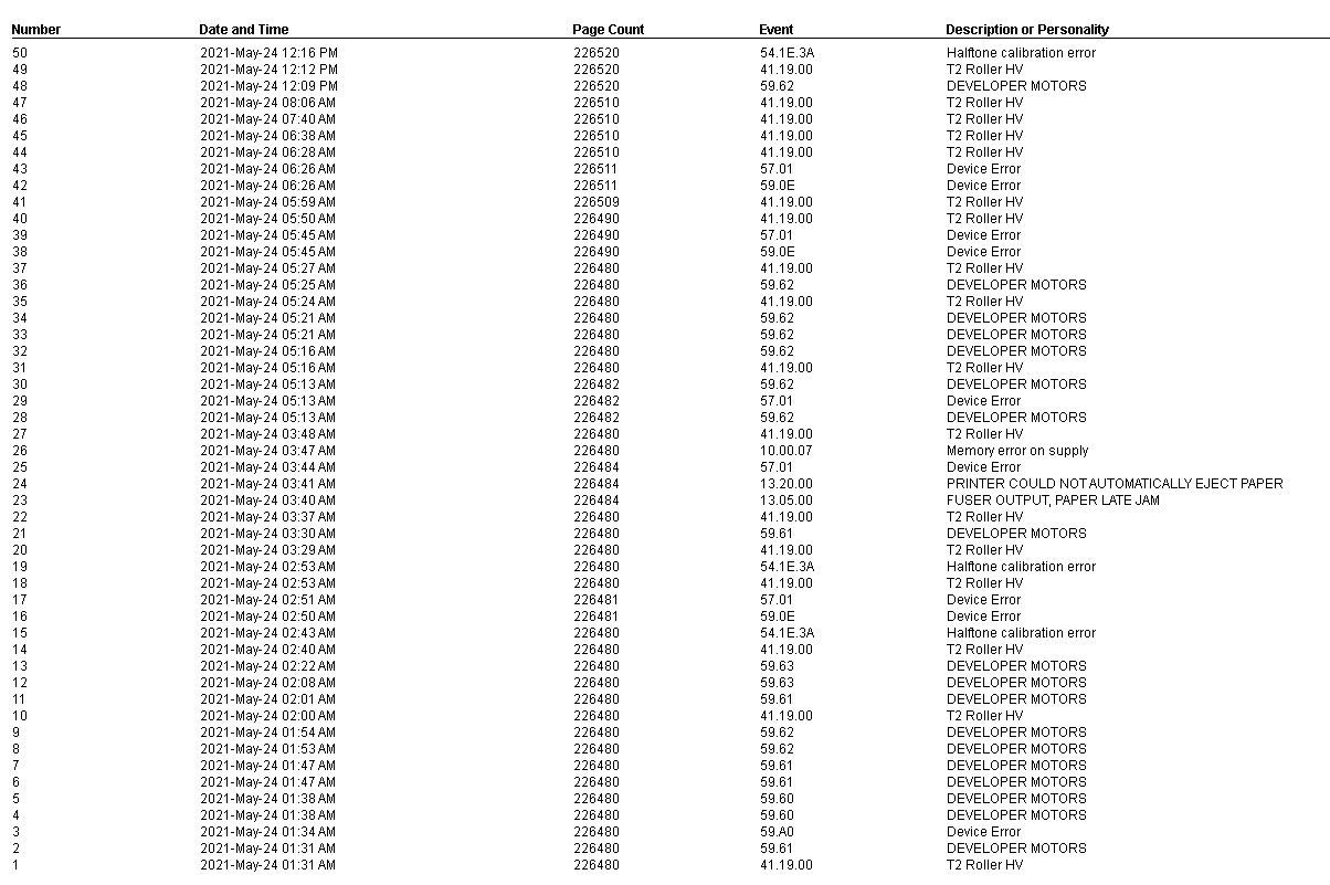

error log:
http://lefel.1-click.hu/clj9500/err.png
0302err
