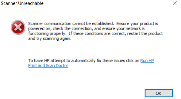

I have the same issue, and did all suggestions.  I have uninstalled all HP software, reinstalled it, not fixed.   Uninstalled all HP envy, uninstalled drivers for envy 4500, reinstalled.  Not fixed.
If I try to scan from any computer app I get the attached error.
   I have used scan doctor it says I don't have the correct drivers.  My drivers are all correct and up to date, those have been uninstalled and reinstalled multiple times.
I have tried both a wi-fi connection and USB
I have always had a connection and can print with no issues.
scan doctor once I skip past the drivers then gets hung up on WIA for about an hour, once past that it still will not scan.
   It is crazy how about two weeks ago it worked fine.  I am thinking some new update on windows side has now made the scanner messed up.
    Occasionally using the envy 4500 scan app it will tell me the scanner is busy even after I have unplugged it and restarted it,  Nothing is printing or scanning when I am told it is busy with another job.  I will hit print and print,  then try to scan and it will say it is busy.
