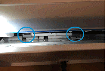

  • With the flashlight, look down into the input tray and find the paper pick rollers.
An example of paper pick rollers on top loading printer
  • Lightly dampen a cotton swab with water, and then squeeze it to remove any excess water.
  • Clean the rollers with the swab, rotating the rollers with your fingers to completely clean them.

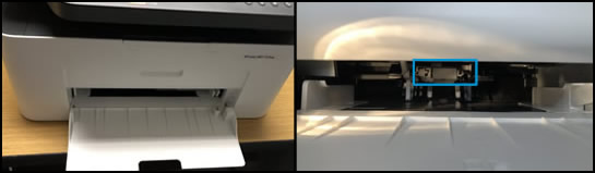

  • Depending on your printer model, use the flashlight to find the paper pick roller.
PRINTERS WITH THE ROLLER UNDER THE CARTRIDGES
Printers with the roller located under the cartridges
Rollers in the paper tray area
  • Allow the rollers to dry for two minutes.
