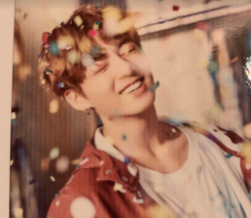

My printer is printing streaks whenever I use photo paper. The print diagnostic page looks fine. The printer alignment page looks fine. But when I print on photo paper, there is noticeable white streaks in the image.

Have you tried a different brand of paper. This issue can be caused by paper advance issues and different papers will have more or fewer problems with this.

I’ve been using the same brand of photo paper ever since I got this printer, so there used to be no issues when I print. I don’t think it’s the type of paper that is causing the issue. Could it be a hardware problem?
