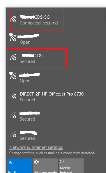

>>> 4. I got that online with my PC (Toshiba).  The internal router has options for 2.4 and 5G.  Field servcie suggested I use 5G because there is less traffic.
@DebH711
Printer supports 2,4GHz only. You need to allow your router to broadcast BOTH (dual) bands. Please check your Toshiba, can it see BOTH SSID's ? For example: my machines can see BOTH SSID's from my router and few more from my neighbors:
Regards.
BH
Hi Banhien,
Yes, the network lists both options.  I have connected the 2.4G option only, but it still says the printer is offline.
I am in the process of looking at the Microsoft updates, but it looks like the KB3147458 update had serious flaws.  I cannot find it to update.
I have, also, gone to the spooler settings to make sure Pause and Print Offline are not selected.
Regards DebH711
