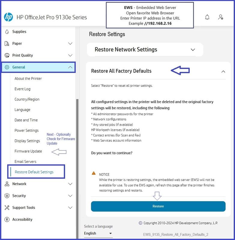

Next, Restore the printer to Factory Defaults
Open your Browser > Type / enter the Printer IP address into URL / Address bar
Section General > Restore Default Settings > Restore All Factory Defaults
Open EWS - Restore Printer to All Factory Defaults
EWS_9135_Restore_All_Factory_Defaults_2
