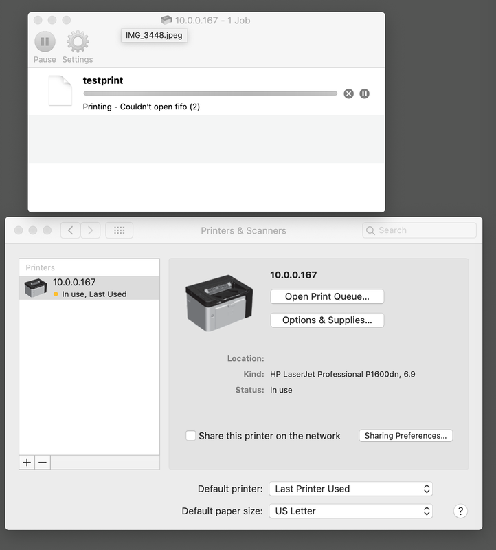

in addition to printing this status sheet I also tried to connect to the printer directly via IP address, since this sheet has the IP. I could add the printer but it still didn't work.
I also updated the printer firmware to 2015 from 2012. I couldn't do it on the mac (per my previous post) because the firmware updater for mac doesn't work. I updated it on a windows 7 laptop. the newer firmware doesn't fix the issue; I still can't see the printer from the Mac with Mojave.IMG_3450.jpeg
