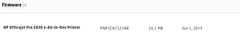

Hi folks, can you please try the latest firmware (released 1st June) and let us know if that resolves it?
http://support.hp.com/us-en/drivers/selfservice/HP-Officejet-Pro-6830-e-All-in-One-Printer-series/53...
Thanks
Ciara

This firmware is from March 20, 2015, same as the old firmware. Please provide the proper link.
Hi @jwayt
It's not the driver, when you scroll down to the Firmware section you should see a link for an update from 1st June.....
Let me know if this works
Cheers, Ciara

Hi Ciara,
Thank you for your update. I believe it is much better now after the firmware update. When I put my ear near the printer, the noise is slightly there but I think this acceptable. The green light does not flash anymore. Later today when it it will be less busy here in the office, I will be able to give it a final check but for now I believe you HP guys did a wonderful job. Later today I will give my final conclusion here.  Thank you very much!!
I agree with italianfox after downloading 6/1/2015 firmware. Noise is still there but not as loud. HP support is sending a new power supply, we will see if that works.
Just got a new power supply sent from HP a few days ago. So far.....it seems to work....no noise! Hopefully it will continue to work properly.
