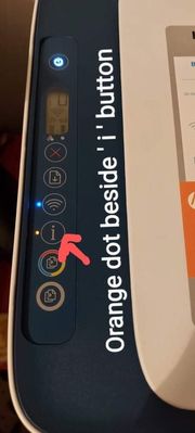

I believe the '!' in your display panel is an indication of the strength of the wireless signal to the printer.
Also check the user manual page 7 for orange light
http://h10032.www1.hp.com/ctg/Manual/c07043348.pdf
It isn’t an exclamation mark at the Wi-Fi icon. The Wi-Fi is fine. The exclamation mark would be beside the Wi-Fi icon if it was a signal issue.
the exclamation mark is to the left of the number of copies led.
eIt says on page 5 that it indicates an error.382ED9C5-ADA0-407A-8A7D-5064E1BA0BF9.jpeg35D5BF80-4599-413A-A47F-EA4D32533503.jpeg

Mine printed out various printer information pages and I thought maybe it would clear after all were printed. The last time I pressed the button it printed a page that it had already printed and the light is still on.
I have the same problem, I have just bought this printer (31/12/21 and this light stays on. This is annoying as I cannot find a fix for this problem. I would like somebody from HP to give us all an answer
Yes, it would helpful to have someone from HP address this issue considering how many people have the same issue. So frustrated at the lack of response from HP.
The answer is to install your first batch of instant ink cartridges that HP send to you in the post. That's what cleared the light for me. Yes wish hp would address this officially. Was really annoying as I didn't know what was wrong even though it was working properly
On my 2752e, when I press the exclamation point (which is where my solid orange light is located next to), my printer prints me out a Printer Information page. Other than the orange light being on solid, my printer works fine. I can remote print with my cell phone and everything else seems to be working fine.
