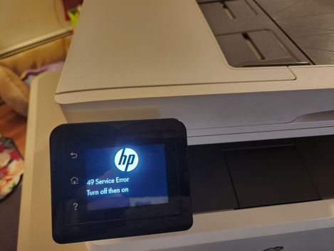

I was posting some updates in another thread, but in the nutshell, when I tried restoring printer settings, I got error 49.
sB9deVs
I called HP support and they were UTTERLY USELESS, as they insisted to charge me $90 for a chance they waste my time trying to downgrade the firmware, when I repeatedly kept telling them the issue was caused by their faulty firmware affecting all 280-281 printers, and people have reported that downgrading the firmware did not resolve their problems.
So I took matters into my own hands.
I followed this and this thread (thank you everyone for your contributions) and I fixed error 49. In my case, I had to jump the below 2 pads and keep them jumped while connecting power to the printer. This took several attempts, as the pads are extremely small.
fgWVEDl
After resetting the firmware and sending in firmware 20220414 (as explained in those above threads, my printer finally came back to life. But when I tested printing, the paper was getting stuck in the output bin just as before.

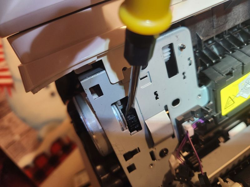

1) I took the right side cover off the printer (this may be a little challenging, but if you search videos online, there's a guy showing how to take it off on that printer).
2) From behind the fuser, I removed the gear assembly attached to the right side of the fuser. Once you remove the screws, you'll have to gently unhook the black tab, and then lift up the assembly to unhook the top metal tab.
YEJiPkd
3) I moved the white gears inside the box, and all moved freely. Then I removed the solenoid/actuator (whatever it is), and it was also moving very freely.
eqHyfrc
48KzXmB
4) Then on the other side, at the fuser, I checked both points where the gearbox connects to gears. The white gear was moving very freely. The black one has some resistance, but that's normal, because it's on the motor. I moved the black gear with a flat screwdriver up and down several times.
ecuiUx8
After that I assembled everything back, and tested multiple times. The printer is working perfectly fine now. No more paper jams !!
