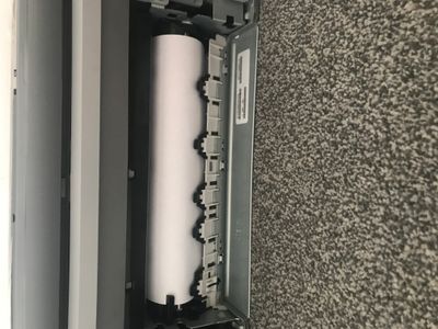

I have checked them rollers and they ‘seem’ okay,
I have attached a photo of how far the paper gets the just stops and you can hear it trying to pull it through but it’s not grabbing or pushing it through
thank you!
Is that normal plain paper? If you push it with your hands then it passes trough?
My profile on LinkedIn
Hello,
yes it’s normal plain paper, yes if I take the back cover off and give it a little help then it takes it
