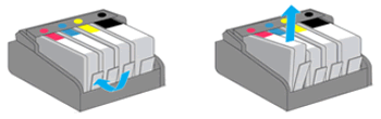

  • Push in the tab on a cartridge, and then pull the cartridge from the slot.
  • CAUTION: Do not leave the cartridges outside the printer longer than 30 minutes. Doing so can result in damage to both the printer and the cartridges.
  • Removing the ink cartridge

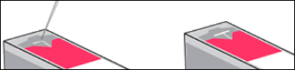

  • Use a pin or paper clip to remove any debris or excess adhesive from the vent on top of the cartridge.
  • Cleaning the vent on the cartridge
