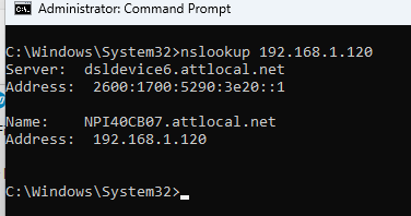

If the IP4 address is 192.168.1.120 then find it't hostname
you can obtain the hostname using the windows administrator command prompt and entering the following command.
nslookup 192.168.1.120
The hostname NPI40CB07.attlocal.net can be used to access the printer even if the IP address of the printer changes.

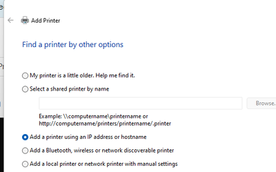

In windows 11,enter "printers and scanners" in the search bar and use the "add a printer manually".   select the TCP/IP not IPP after clicking next.
