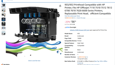

The cartridge error came when I tried to fix a printhead issue. I replaced the printhead with an aftermarket printhead off amazon (link and screenshot below). Since the new printhead was causing issues, I returned it and installed the original printhead. Now I am back to my first error of "there is a problem with the printhead". Can you help me troubleshoot that?
(https://www.amazon.com/dp/B0F1TD3CLD?ref=ppx_yo2ov_dt_b_fed_asin_title
