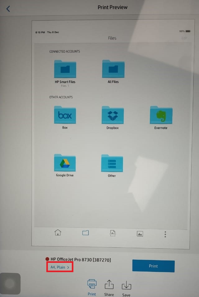

You can install the HP Smart App on your iPhone, that should give you presets to select size, color, type of paper etc.
Try these steps to install and use the HP Smart App.
Step 1: Go to 123.hp.com from a browser on your phone or tablet and install the HP Smart app.
             The HP Smart app icon
Step 2: Open the App, follow the onscreen instructions and complete the set up by adding the printer. Check this link for further details.
            (Make sure your mobile device and printer are connected to the same wireless network.)
Step 3: Open the picture that you would like to print.

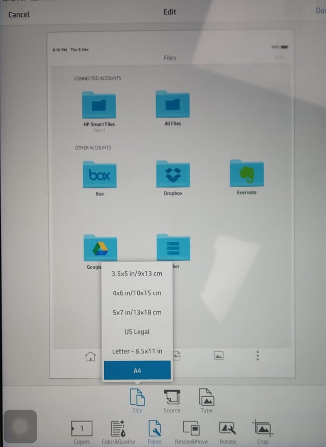

Step 4: In the dialogue box that appears below the HP Printer, the paper size and type would be displayed.
Step 5: Tap on the Paper Size and that would provide you an option to select various presets like paper size, type, color etc.
Select the preset of your choice and try to print.
Let me know if this helps.
