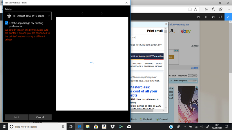

I am having problem with my HP Deskjet 1050 J410 series printer. The printer is set as my default printer and will print text from my notebook and will successfully print a test page. However,when i try to print from the internet or from documents sent via email it will not print them.
When i try to print i get a black box appear on the right hand side. It has the printer name at the top and underneath it has the following message.
We could not reach this printer.Make sure the printer is on and you are connected to the printer or try a different printer.
Clearly the printer is on and is connected properly because i can print text from my notebook and a test page. I have downloaded all the necessary drivers and used the HP Print Doctor without success. The HP assistant informs me that i`m up to date with all my downloads etc.

Hi David,
The issue is printing email attachments,word documents and PDF files.
 this is a typical examplethis is a typical example
Thanks for your help

Hi Raj,
Thank you for replying to my post. I have downloaded and installed HP Print and Scan doctor it identified and ran a check on my printer. It stated that their were a couple of issues which it fixed. It asked me if I wanted to print a test page which did and this printed correctly. However, it still will not print emails for some unknown reason?
