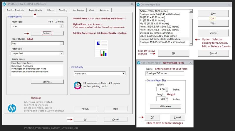

What about Custom Paper Size Forms?
Creating Custom Paper Sizes
Control Panel > icon view > Devices and Printers > Right-Click on Printer > Printing Preferences
Paper / Quality > Advanced > Paper Size
No "standard" envelope of your intended size in Advanced > Paper Size?
For example, if you do not find a 7x5 inch envelope in the list of available envelope sizes, you can create a Custom Paper Size form for your envelope.
  1. Availability depends on printer model and software and Operating System / Version.
  2. If the feature is at least partially supported the Custom Setup will be available in Devices and Printers OR in Printer Preferences.
  3. If the feature is fully supported, the custom form can be created AND then used with the printer software.
  • Devices and Printers > Print Server Properties
OR
  • Printer Preferences > Print Dialog > Paper / Quality > Custom setting box
Example 1
Left-Click on your Printer one time to highlight >
Left-Click Print Server Properties (along the top ribbon)
Custom_Form_Envelope_7x5Custom_Form_Envelope_7x5
Example 2
Right-Click on your Printer > If necessary, select printer from drop down menu / list
Printing Preferences > tab Paper/Quality > Custom
Depending on the printer software, "Custom" forms / sizes might be defined in Paper / Quality > Custom
Printing_Preferences_Custom_Envelope_7x5Printing_Preferences_Custom_Envelope_7x5
Depending on Printer Model / Software, changing the paper in the tray may require that the paper settings be adjusted on the printer control panel.  Note that particular forms or Custom size forms may not show up in the printer control panel.  This is normal behavior.
  • Open Tray > Remove existing paper, load new Paper > Check printer control panel: “Modify” > select Paper Size or “Custom” > OK
Load the envelopes in the main tray, short ends front/back, flap left and (flap) facing up.
User Guide - Page 13
Remember to change the paper size / type on the printer control panel.
NOTE:  If you do not find the size you want on the printer control panel, select size "Custom"
Back in your Printing Preferences settings,
Select the Source as the Main Tray (do not leave as "Automatic" or similar).
Select your new Custom size envelope form in Paper/Quality > Advanced > Paper Size
Or
Select your new Custom size envelope form in Paper/Quality > Custom setup
Leave the selections highlighted and Apply the settings.
Remember:  If your software supports it, you can create a custom shortcut from your settings with "Save as".

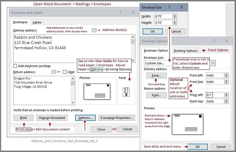

Build the Envelope
Open new / blank Word document > Mailings > Envelopes
NOTE:  Make sure the margins are not too large (shoving the content or chopping the return address).
For example, in Word  > File > Print > Set margins to Narrow (Or set in Layout > Margins)
Open the Envelopes setup and build your envelope.
Remember:  If your envelope size is not in the list, use "Custom" and add the dimensions.
Example
NOTE:   The sample shows setup for an A9 Envelope - the essentials are the same with the exception of the dimensions entered to define the size of the envelope.  For example, your Envelope will be 7" width and 5" height.
