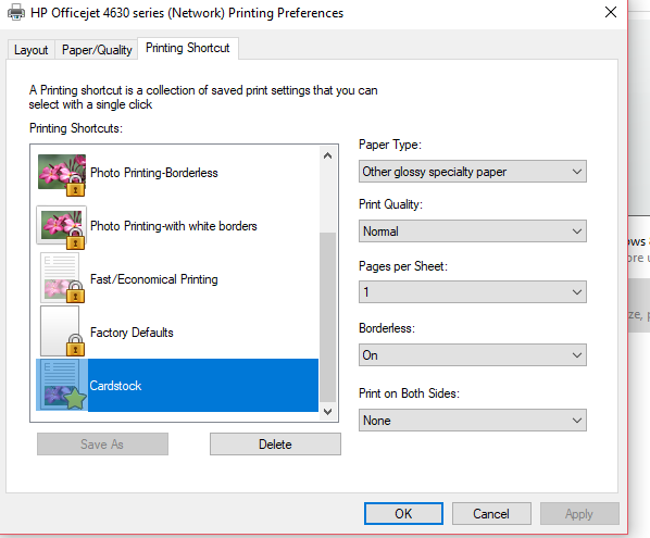

I selected a custom paper, shown below, and ONCE it printed correctly, but then subsequent printings did not work and were again off the page.
I'm really puzzled and frustrated. Should I try the next step below? I recently reset my whole computer, so I installed the software at that time. I'm wondering if the paper is just too thick (65lb), though I think it's within the spec for the printer.
