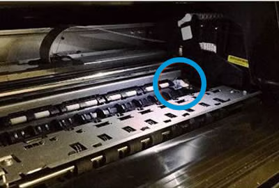

Check for obstructions in the carriage path
Clear obstructions from the carriage area inside the printer.
With the printer on, disconnect the power cord from the rear of the printer.
Open the door to access the carriage inside of the printer.
Look in the carriage path for debris such as crumpled paper or dislodged labels, and then remove any that you find.
”言籌,쭈=한-墨 `

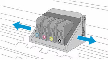

Use your hand to move the carriage to each side, making sure it moves freely. If the carriage is stalled or docked to one side of the printer and you cannot move it, continue with these steps.
