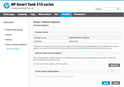

@Riddle_Decipher
The image is located in the upper left corner of the scanner. Where there is a special pointer.
Copying, as well as scanning to a computer using any program, give the same result by trimming the edges.
Programs:  NAPS2 / HP Smart Tank 510 series-HP Scan Classic Microsoft Paint in Windows 10 .
The latest firmware version of the printer is installed:
*I found a video on Youtube with a review of this MFP model. Contacted a person and you know what? The person also has a problem with trimming the edges.
