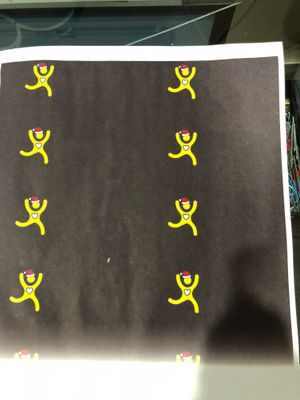

So I updated my Mac OS to 10.14 this week and then found that my HP printer doesnt seem to like this.  For some reason, it will print regular documents okay, but my labels print either incorrectly from Adobe Acrobat, or in full black with only the contrasting picture in color from Preview.  See photos below.  I have reinstalled the HP drivers for the device.  I have replaced the ink cartridges.  The documents print fine on my old HP 1020 laserjet, just no color.  Is it my printer gone bad coincedentally at the same time as the update or something different.  any help is appreciated.

Normally this happens when the PDF file contains damaged content such as images or fonts that Acrobat or Preview cannot process during printing. Could you try printing a different PDF file.
Senan6806
I am an HP Employee
Other pdf files print fine from both adobe and preview.  I printed to this printer from another mac and had the same problem.  Then printed to a different printer from the alternate mac and the file printed fine.  Challenge is I have about 36 files that are basically similar and will have the same problem.  I am not sure that there is anything broken in my files but the printer for sure seems broken to me.
