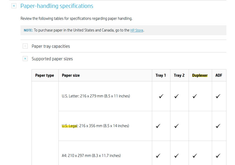

Hi,
Duplex printing or copying is supported on US Letter / A4 paper, it does not support a US Legal sized paper.
You may find its specifications below:
https://support.hp.com/us-en/product/hp-officejet-pro-8620-e-all-in-one-printer-series/5367611/docum...
You may manually copy or scan using the ADF with Legal Paper, to copy place a page on the ADF and copy 1 > 1 Sides, then reload the other side of the original and reload the printed paper facing up with the top edge into the tray.
To scan launch the scan from the HP Scan Software or HP Smart and scan the first side, then reload the other side and click the Plus sign to scan the next page, once you are done click the Save button to complete the scan job.
Shlomi
